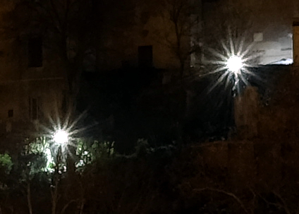

The Samyang 12mm is an awesome lens which I'd recommend for a lot of things. Sun stars isn't one of them. The Samyang has an even number of 6 aperture blades which results in six pointed stars. The fujinon 14mm for example (and loads of other Fuji lenses) have an uneven number of 7 aperture blades which results in the double amount of star points, 14. Samyang 12mm:

Been googling a bit and most fuji lenses have 7 rounded aperture blades and should all perform about the same for starbursts. Of course the focal length is totally different and some lenses have certain characteristics so you might prefer one over another.
If OP wants a starburst with more than 6 points than he needs a different lens than the 12mm. I am happy with it, obviously otherwise I wouldn’t have posted my picture above which, as far as starburst goes is pretty similar to yours.
It is possible to use lenses with 9 or more blades but generally those lenses try to achieve a round aperture which is not what you want to create starbursts. You can also do this with software or with filters.
I meant I used it as a bad example you as a good example. So there are no "best" starbursts. If you want 6 like the example you can buy the samyang 12mm if you want more choose another option. Personally I don't mind 6 points but I like a sharp clean starburst and not like the spread out points like the samyang.
yes, no problem, I too am not greatly in love with this particular effect which I use very sparsely, but  it is possible to get a better star (I find yours better than mine :) ) with closing the aperture past f8 but the quality of the picture drops dramatically with the 12mm past f11.

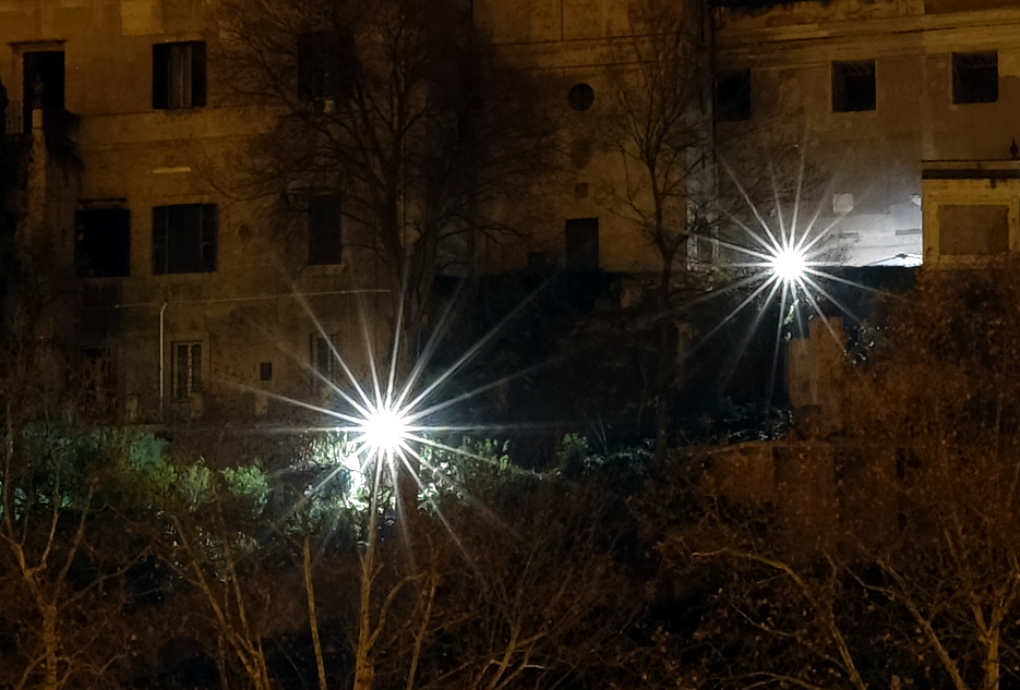

So there are lenses with better performance, both in terms of coating and in number of blades making more corners, they tend to be the lenses made in the ’80 or ’90 when coating was very much developed and the cameras were predominately reflex (circular apertures such as Leica are very bad at doing this because they are ... too good... too circular.
I had a Tokina 17mm which I seem to remember gave very good results with this or perhaps the Pentax 15mm. I had both at some stage, long ago.
these are all examples which strike me for their nice star patterns.

I prefer sunstars with lots of points that taper the further you get from the sun. Personally I think the 10-24's 14-point sunstars are ok but not great. They're still much better than the Samyang 12mm and its 6-point stars that flare out from the sun. The 10-24's sunstars don't taper toward the ends like the 16-55's either, but they're still smaller than the Samyang. The 16-55 has a 9-blade aperture, which gives you more points that taper toward the ends, the sunstars are perfect IMO. The first image is from Cambodia with the 10-24, which has 7 aperture blades. The second is from Egypt with the Sony 16-35/4, which also has a 7-bladed aperture, but produces nicer sunstars - presumably because of the shape.
