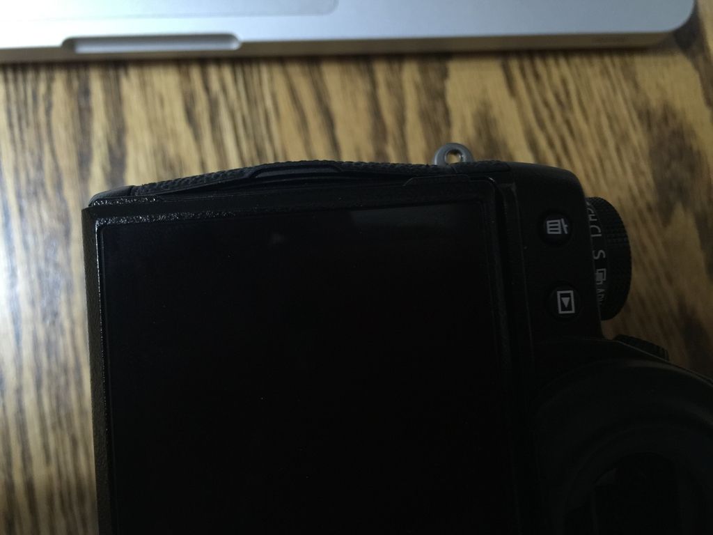

Does anyone know if it's possible/how to remove the accessory door? Mine's been bulging over the past few months, and it seems to be getting worse (despite the weather not getting much worse than 25C so far).
It looks like the rubber door is slightly too wide, so when it expands, it pushes up harder than the seal can hold it. It seems like I could shave or file the top and bottom edges of the door down slightly and get it to seat properly. I just can't get the door off, and with it on, I can't get at the entire length of the edge.
I should be able to get the door replaced by Fuji under warranty, but that would require me to send it away, and it's my only camera and I use it for some paid work. Also, I don't really want to replace the door, just to have the new one start bulging again. From what I've read online, replacement doors aren't any different than the originals, and they start expanding again.

When I first received my X-T1, the door worked just fine.  Then I had my camera worked on for the dreaded light leak problem that affected a number of the early cameras, including mine.  When I got it back, the door bows like the ones mentioned above.  My current solution is to take a piece of black gaffers tape and tape it down, which works fairly well.
I have looked into a possible DIY solution and I am considering trimming the inner door seal on the bottom and see if that helps. I have owned several Nikons (D80, D300, D700) that have experienced similar problems with the exterior rubber coating apparently slipping, swelling, and not fitting over time, so this is not a problem exclusive to Fuji
As far as water resistance goes, I have already used the camera in its current condition through several downpours and have had no problems.  Short of dunking the camera in water (which I would imagine would get in the works regardless of the condition of the side door seal), I don't see a problem.
This is my thinking. I'm suspicious my warranty will be voided anyway, and I'm not particularly worried about the weather sealing - I'd rather have it sit cleanly just so it doesn't bug me. I'm looking into it tonight after work, so I'll post if I go through with it.

I shaved the top and bottom of the door down slightly, but it still bulges a bit. It's definitely a problem with the front corners of the door (away from the hinges).
I'm pretty sure the main problem is the corners of the inside lip of the door.
