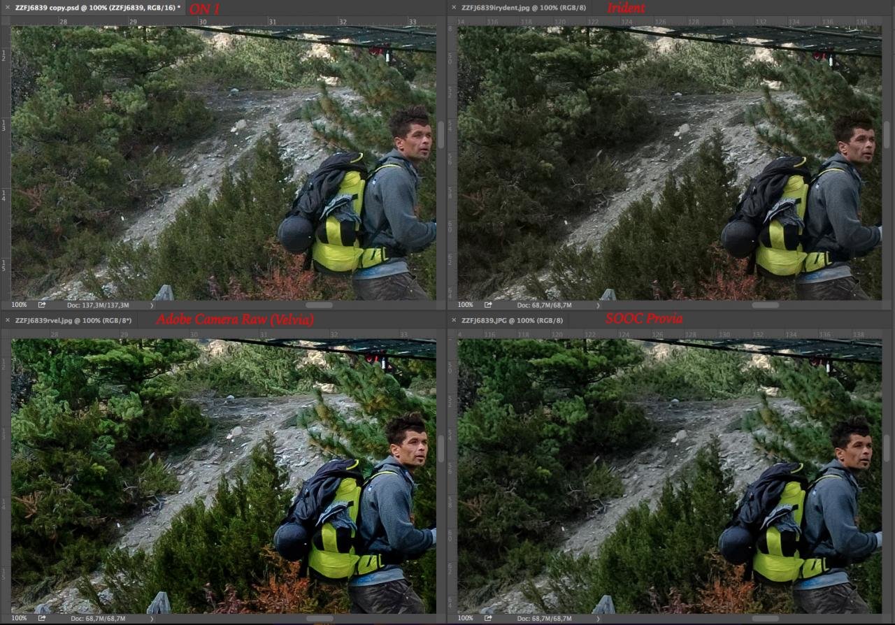

Alright. I took the RAF file posted here by Graflex, and ran it through the Iridient + LR process I do to all of my images before working on them (the settings mentioned in the post I listed earlier).
Here is a Google Drive link to the full 16bit TIFF export. (mind you it's very large, 92mb!)
https://drive.google.com/open?id=0BzSuTVfzBjhQc3BIWGRLOTFCeVE
The watercolor problem is completely gone!
Here's a JPG of the side by side comparison. Left is the imported but otherwise unaltered RAF in lightroom, the right side is after the iridient + lr steps.
https://drive.google.com/open?id=0BzSuTVfzBjhQTEl4eDRmcjFnN2M
The left side is muddy / watercolor, the right side is sharp and clear.
