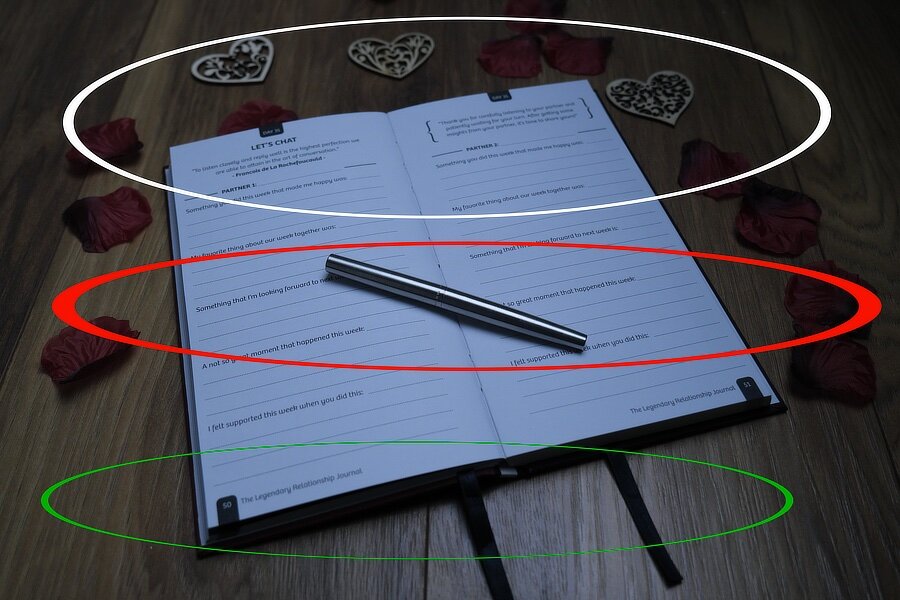

Apologies it took a while to get back to you. I had to retake a photo and share a RAF.
thank you for your help
https://drive.google.com/file/d/14b7P2XHNJ14pzhtaQGEFUMubnrE5CJew/view?usp=sharing
This is the effect you get from shooting at f4 i.e. shallow depth-of-field (DOF).
If you look at the regions, the red one is 'sharper' than the green one or the white one. If you look closer at the green one and the white one, as you look from the center of the image out to their respective edgee, the 'sharpness' fades out evenly -- based relatively from where the camera was held.
If MDM is online today, he can show you some PP (post processing) ideas to remove softness. In the film days. photographers used various techniques to 'fix' the images such as unsharp mask and other contrast enhancers. Digital photographs sometimes need that same approach.
From the taking-the-shot perspective, for things like you have here, try using more DOF by way of increasing the f-stop. Start at say f5.6 or f6.4 and go up from there, but do not be surprised to find yourself shooting at f11 or so. There is also a technique called 'focus bracketing' that can be really handy for shots like this.
Do not be afraid of boosting the ISO to keep the image from being dark, the X-T4 has plenty of noise free latitude. Of course, there are tripods.

Thank you Jerryy! I'll definitely try it out :)
Hi Ruta, I've checked the RAF in Capture One and you can see it shows the focus plain of the image painted in green.
So, as Jerryy pointed out it's a very thin DOF that makes the most part of the image unsharp. Besides even shooting at F11 or F16 from this perspective you hardly get all-in-focus image. I agree that focus bracketing or focus stacking is the only way to go here.
What about your lens it's perfectly fine. I upload processed file and as you might find the area which is in focus is tuck sharp.
