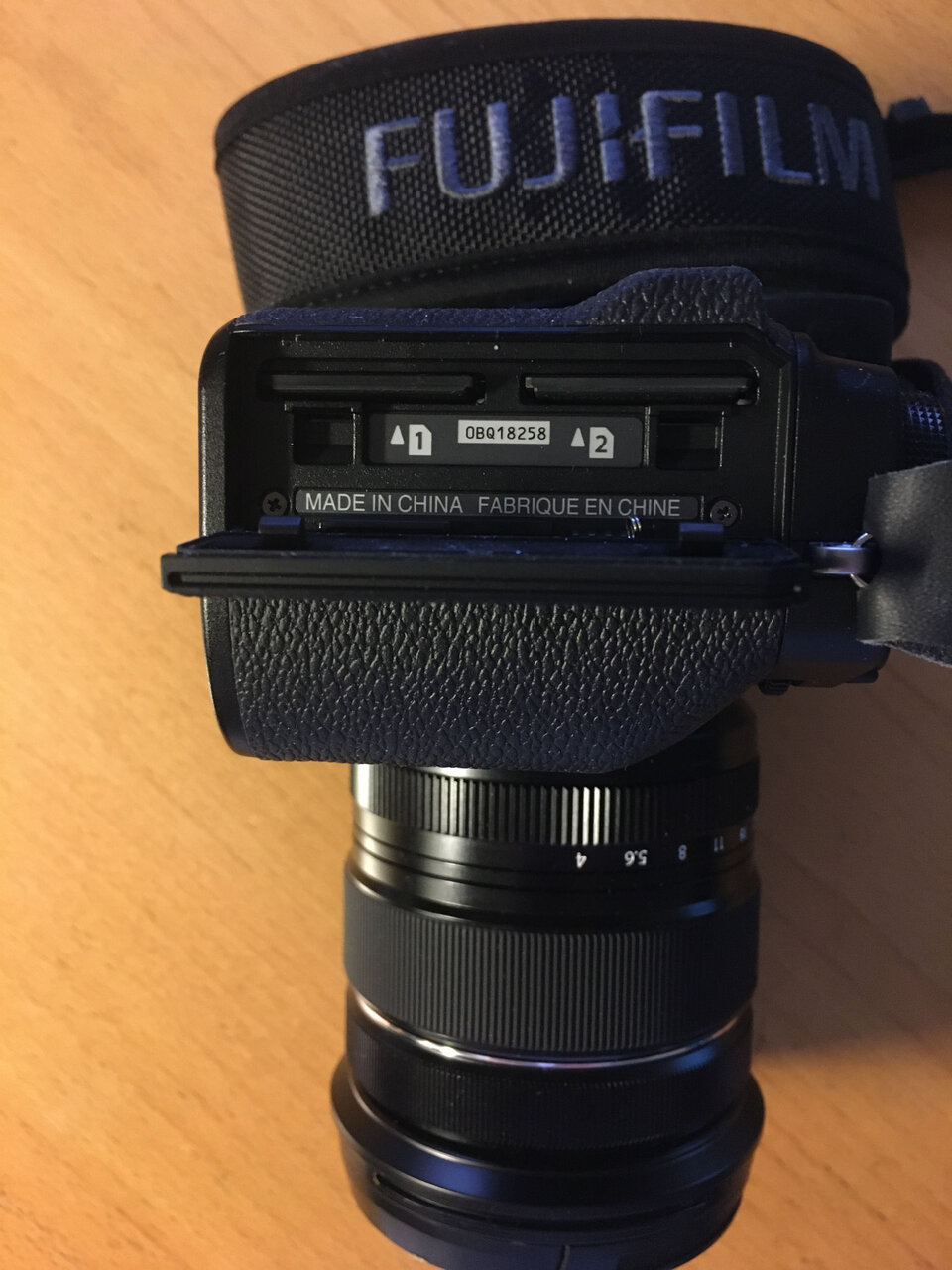

I have now contacted the reseller Scandinavian Photo and I selected to use my consumer right to just return the camera and lens, and then get a another brand new X-T4 and lens (as a package, as I originally bought it first time) from them. That way I avoid any discussion on a warranty situation. The person at Scandinavian Photo was very friendly and said that will be fine do so so.
Mobdro
Edited by brewmaxwell649
I want to give Fujifilm a second chance, but if same problem with the new X-T4 camera I will get next week I will have to switch to another brand since then my patience will be gone with a Fujifilm camera. I asked Scandinavis Photo if I could return everything then (also the accessories I bought like two chargers, two batteries, one hand grip, etc) and buy another brand of similar camera and they said that I could do that.
I hope my X-T 4 was just a "lemon" and a very rare defect camera that left the Fujifilm factory in China.
I also want to tell you this, that I received from Fujifilm Nordic support today July 16 2020:
"Of course it should not be any freeze and I have talked to one of our product specialists regarding this. It has nothing to do with the firmware, it seems to be a problem with the camera."
/Bo
Sounds like quality control at the Fuji China plant is taking a hit from Covid 19 . Have 10 Fuji lenses that I’m happy with and was looking to acquire the xt4 .Experience from my xt1 tells me that a freeze is fixed with a new motherboard ie. Off you go …back to factory but what worries me more is when the camera seems to be unable to rapidly refocus on the nearest object (which is the bread and butter of any event photographer). Hope to hear good news soon .
