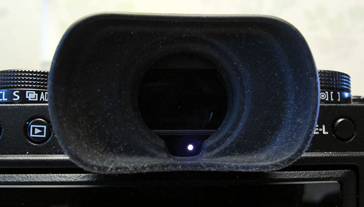

Since I've installed FW 4.0, I've noticed that the eye sensor IR spot remains lit (red glow) when I switch off the camera. It's weird.
This happens only if "performance mode" is activated. In normal mode, it still behaves normally.
Have you noticed the same thing or am I the only one?

Funny...! I can't replicate this on my X-T1... No sign of red glow coming from the eye sensor when switching off the camera when using the "High performance" mode. Wondering why...
Light pollution. Try it in a really dark room at night.
Thanks guy for your feebacks.
Yes. I noticed it last night, but dismissed it. The fact is that I had never noticed it before the upgrade. This is what I am observing now:
  1. It comes on with either "High Performance" set to 'On' or 'Off.'
  2. It turns off with Power Switch in 'Off" when "High Performance" is turned 'Off.'
  3. It also comes on with the EVF turned 'Off."
  4. It stays on for approximately 15-20 seconds but their is no fixed pattern.
  5. You can turn the light off earlier by popping the battery out.
  6. With "Sensor Cleaning" turned off, it only stays on for about 1 to 3 seconds.
Based on limited observations, I conjure that it is somehow being affected by the sensor rather than EVF/LCD.
Cheers!
Cheers!
Omer...
Thanks for sharing. I was curious so I did the same tests but I didn't agree with your 4th observation: in all the tests, when "High performance" was on, the IR light remained ON for more than five minutes. Eventually it went OFF, but I was no more observing it, so I don't know the total time it stayed on. Also I observed differently from your 6th observation: even with sensor cleaning turned off the IR light remained ON for more than 5 minutes.
Hey Patrick!!! Hello FUJI!!! I think we can call this a BUG in the firmware!
