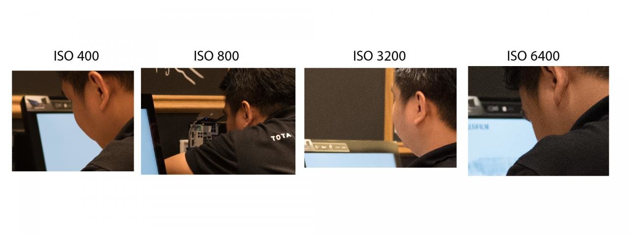

Tested the xt-2 in a camera shop. Lighting was indoor lighting in a normal shop.
I find that noise tends to come in around 3,200 & 6,400 was very noisy & grainy to me.
This kinda holds me back from purchasing the xt-2 for a moment.
Here's a quick simple comparison. Please download the actual files here & tell me what u guys think:
https://drive.google.com/open?id=0B-Mudsk627xpS0t2V2dfSUY5RVE
- Raw files using Lightroom
- Shot using 35mm f2
- constant f2 for all shot
Hmm, I actually think the camera does a great job. Iso 6400 has no waxy skin tones. Looks like grain.
What do u think bout the skin & black board here with 6400 ISO, 100% cropped?
