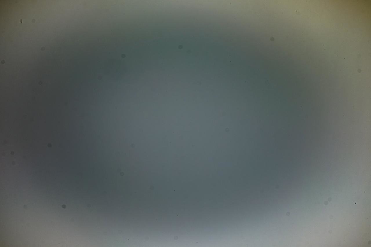

The harm is in the $$$ :D Attached is a scary shot of the sensor dust (highly modified RAW capture with a clean lens)... man, I THOUGHT I was careful with my sensor! I almost never expose the sensor for more than 1-3 seconds when switching lenses... a few times I've made the mistake of changing at the sea - perhaps that's how all this junk got there.

Wow, that’s intense!

Got my Eyelead sensor cleaner today. Was a bit scared to try it at first, as the packaging gave no indication of whether it was the Sony/Fujifilm one or otherwise. Below are the before and after pics. Took most of the spots off. The most prominent of the remaining spots wouldn't come off at all (hopefully it's not a small scratch).
Before:
After:
