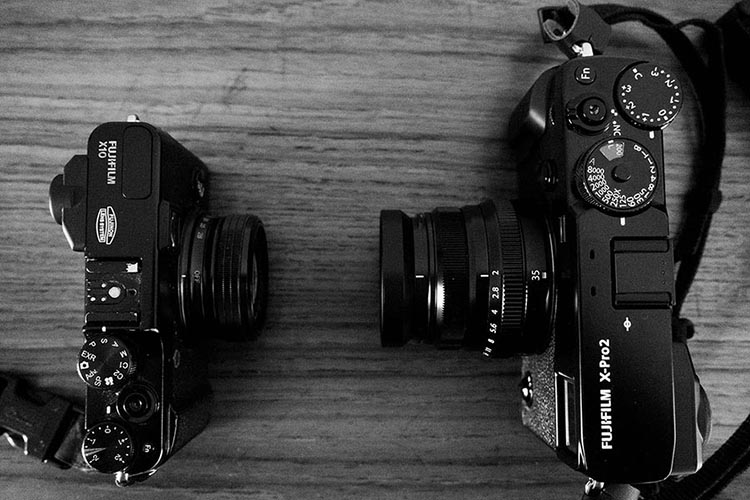

So far its great!
Looks good with my old X10
