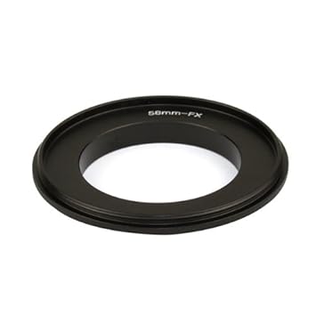

All you need is a wideangle lens and an inversion ring
https://www.amazon.com/Pixco-Reverse-Adapter-Fujifilm-X-Pro1/dp/B00BBPK2AQ
