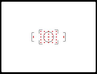

One thing I haven't seen anywhere is what the distribution of AF points across the viewfinder the GFX 50S has.
Is it better than the Pentax 645Z:
I appreciate there are no PDAF points, and it is all CDAF, but I am curious to know if it has more than the one AF point of the Hasselblad X1d.
Edited by Sator-Photography
BTW I already know the answer to this question.
There is fairly extensive AF point coverage on the GFX 50S, and it is similar to that found on the X series. Yes, I know it is CDAF, not PDAF. Yes, I know there are no PDAF points on the Sony 4433 sensor. No I never said there were any PDAF points on there. Yes, I do know that the GFX 50S is a mirrorless and doesn't have a dedicated off-sensor PDAF autofocus sensor like the 645Z (and which is limited in size thus restricting the PDAF points to the centre of the viewfinder).
Yes, there still is a point to the question of CDAF autofocus point coverage because the Hasselblad X1d has only ONE (yes, one!) AF point, though there are apparently plans to improve this in an upcoming firmware upgrade.

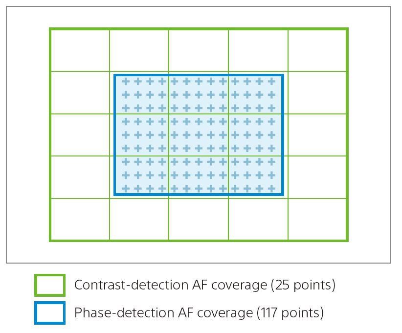

CDAF points do not necessarily always cover the entire viewfinder. Here for example the Sony a7, which has CDAF autofocus points that covers much but not all of the viewfinder:
These CDAF autofocus points are not small, well defined points or crosses, but they are usually called points nonetheless. If others want to come up with their own preferred terminology, that is 100% fine by me :)

BTW that's Sony that's calling them CDAF "points" in that quoted diagram. Whether they are software based, based on the main sensor, or on a dedicated autofocus sensor, they are still commonly called "points". Hasselblad too are talking about increasing the number of CDAF "points" on their X1d from having just one point smack bang in the middle! If you want to insist that they be called something else that's fine by me. I promise not to be upset  :lol:
