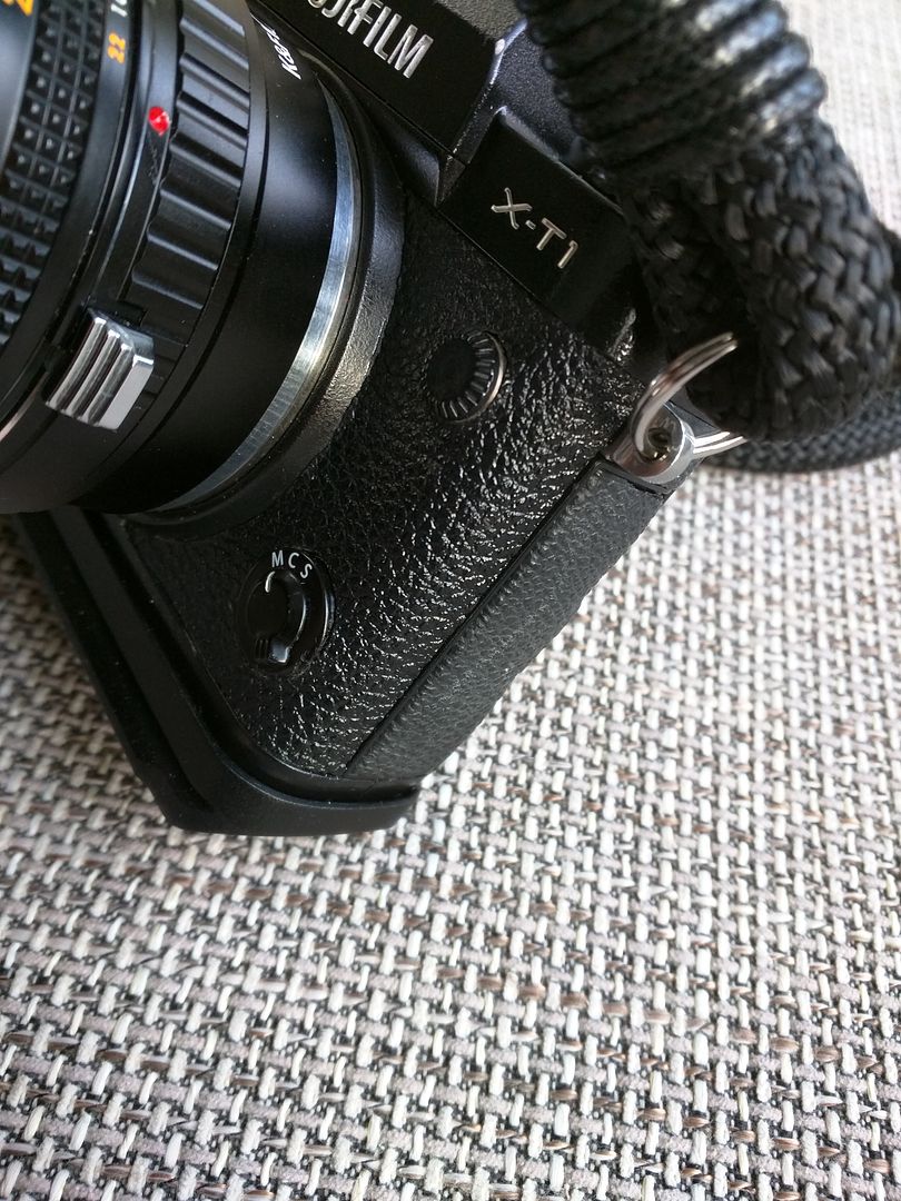

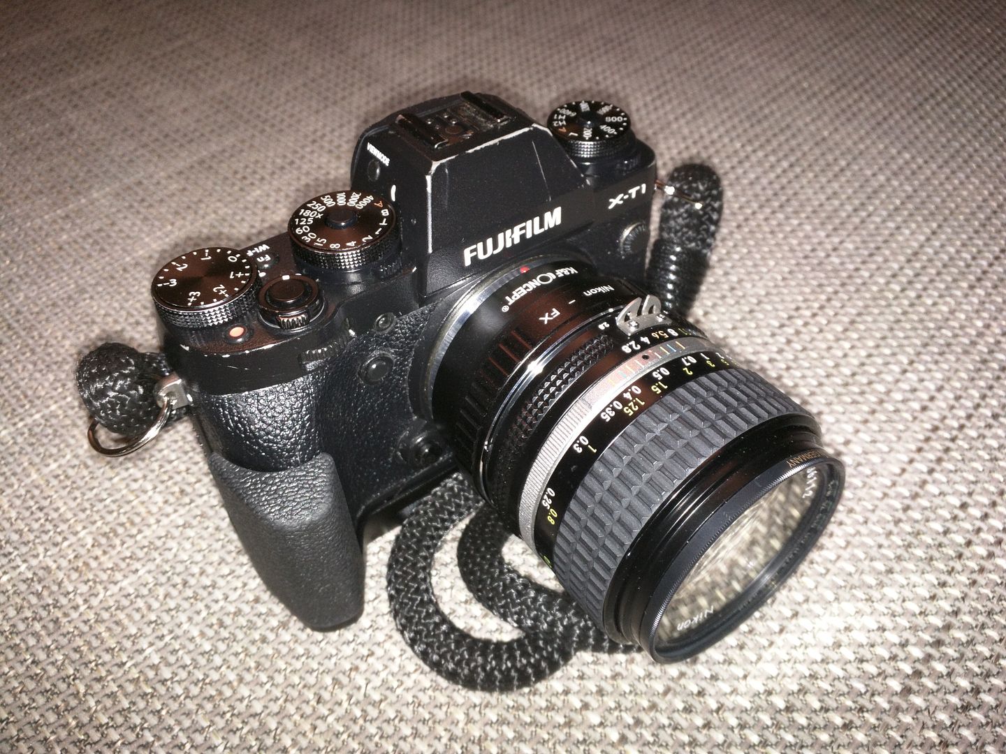

Hi folks, found my solution for the detached rubber and "banana" door on the xt1.
I've got this well used Xt1 with all the scratches on it, making it Oh so sexy and no Milandro, it's is Not put there by me ;). Al comes natural.
Anyway, paid €250 for it. 100% in working order except the rubber and door. The door is in what I called "banana shape", the rear rubber "thump rest" is off, front grip almost, left side corner starts to. It looks nasty so I stripped it all off and cleaned the glue residue.
Wanted to send to Fuji Germany for a new door and rubber as they agree to do it for free (xt1 is only 2.5 years old), but that means my Xt1 will be gone for at least a month. No way :).
So, I ordered Asahi's synthetic leather sheet and went my way. Making templates and start cutting.
This is how it first came in.
received_259286057800901_zps8sibvh9y_edireceived_259286007800906_zpsepkb00l1_edi
Left over, can't re-use it.
received_261010847628422_zpsfik6obij_edi
Here I go,first the rear as it is easier.
This result gave me confidence to move to the front section :)
Left side.
Edited by FujiGlitch
Grip side, that grip looks intimidating! Maybe that's why Asahi can't give us a pre-cut.
Applying process.
And Done!
An additional grip to hide away the lashes. In real life it's less noticeable than on the picture.

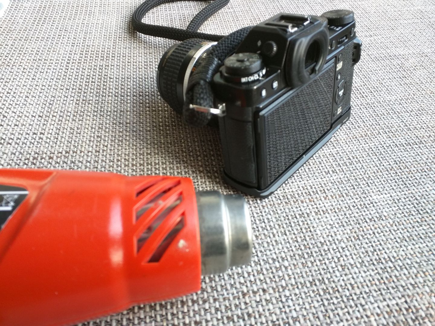

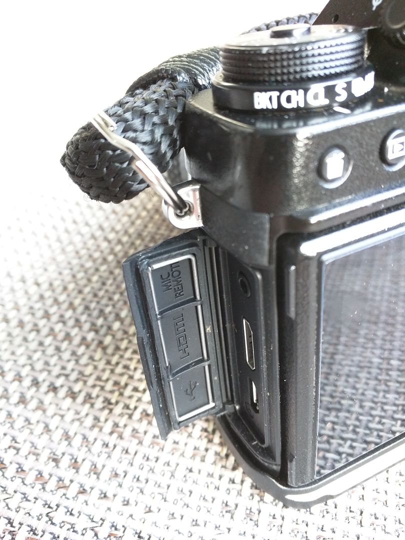

Now the door. Added two "L-shape" frame to straighten out the door.
But that is not enough so I gave It a "heat treatment". Obviously, don't try this is you don't know what you are doing!!
There you have it, all straight and tight!!
Needless to say, I'm a happy guy with my Xt1, it feels solid and even more robust then with the rubber from fuji.
