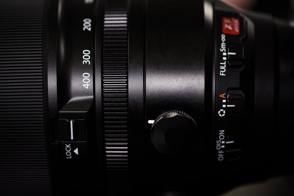

I have a fuji 100-400mm lens and while using in manual focus I have to turn the focus ring numerous times before I can get a photo in focus. I don't have this problem with other fuji lenses.   Any suggestions or tips?
I am sure it says in the book which came with the lens, but there it goes.
“...Located under the iconic red XF lens badge is the focus limit switch, which is essential for many wildlife photographers. Take this scenario for an example. If there was a lion in the distance and grass in the foreground it would make sense to limit the focus past five metres. This is so the lens won’t focus on the grass subject in the foreground, but rather on the lion in the background. The switch features two settings: ‘FULL’ provides a full range of focus, whereas ‘5m-∞’ limits the focus from 5 metres through to infinity.
Fujifilm_XF100-400mm_001.jpg?t=146600059
