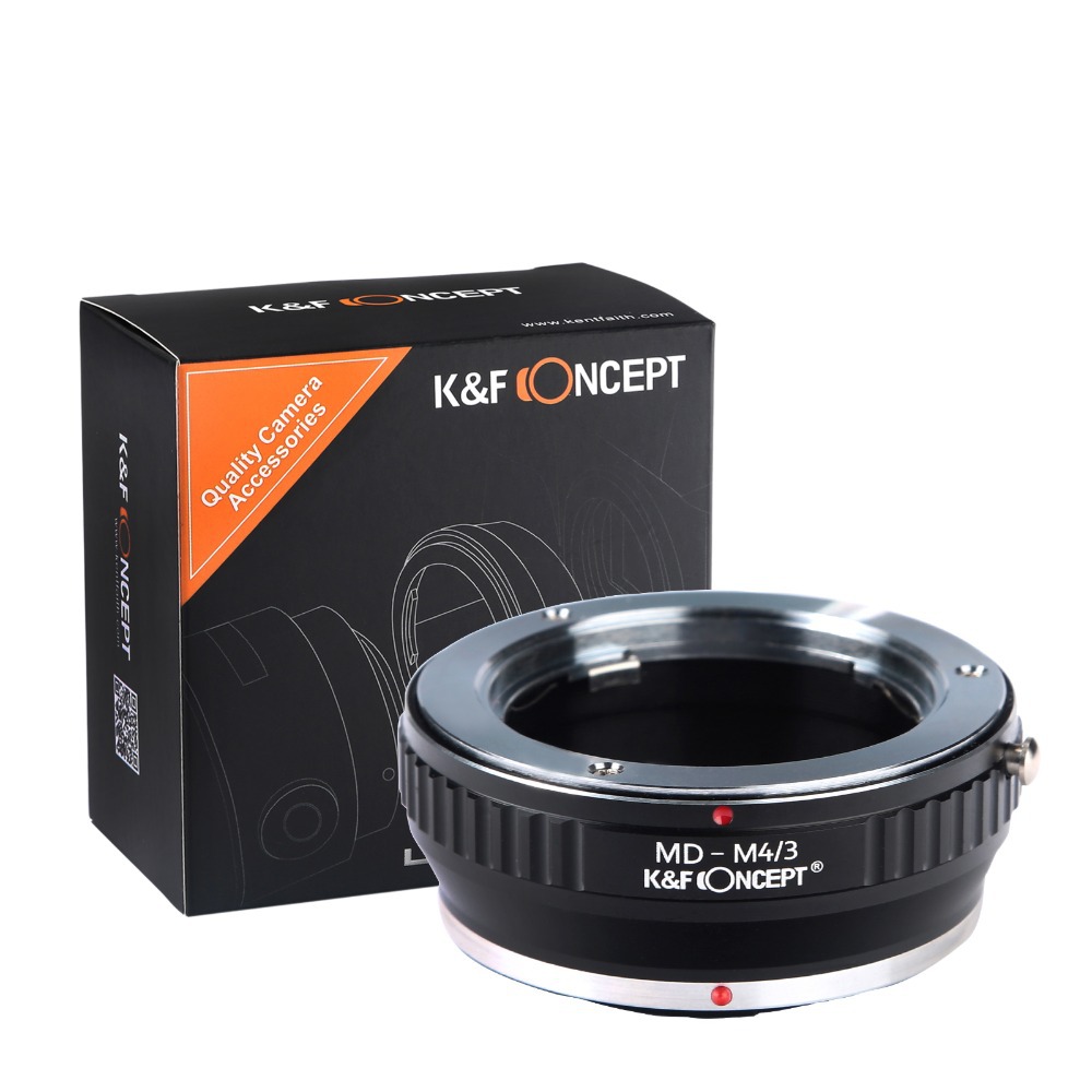

I don’t know if you need to do anything to the front plate. I’d rather think most of the work is selecting the best donor.
You would have to chose, of course, a donor plate of a similar diameter and design to the one on the lens turbo II.
but some of these cheap adapters from China cost peanuts, the K&F is already more expensive than most and it is only $12 or less!
http://www.ebay.com/itm/MD-FX-Minolta-MC-MD-mount-lens-to-Fujifilm-Fuji-X-Pro1-XPro1-Camera-Adapter-Ring-/141314799690?hash=item20e704b84a:g:JU4AAOSwofxUdTSf
the real problem is to secure the donor ring to the lens turbo II made for a different ring because the screws might not be in the same position.
Also the Minolta ring has a locking bayonet with an unlocking push button on the side, this too might not be in the position of the one of for example Canon above.
Maybe wiser to get in touch with the company and see what they can do for you!
However.
Some folks on line have tried a Lens Turbo II ( or so they say) for Minolta but not for Fuji
So the company actually can put a front on a lens turbo for Fuji for you!
It will probably be best and cheapest this way
