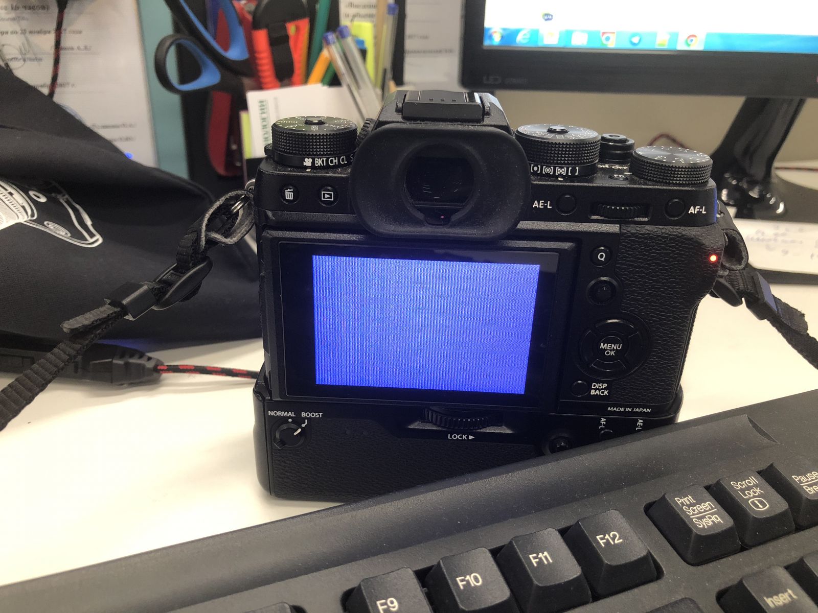

Hi All - i am a bit late to this but am also experiencing problems. I have all original fuji equipment and am using the battery grip for the xt2. All functions on the battery grip work fine APART from that the batteries inside the grip are not used to give the camera any power nor are they displayed (it is as if i didnt have a battery grip). I would have thought that if it is a connection issue the other functions of the grip wouldnt work, but they do. I have not updated my firmware so it might be to do with that, but i am a complete loss! Any help would be much appreciated.
